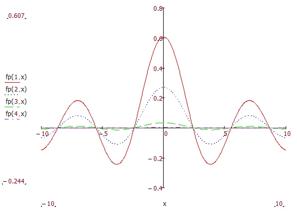

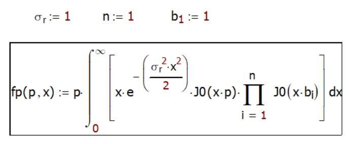

Your Mathcad 15 sheet:
Mathcad 15 - zeroth-order Bessel function of the first kind:
March 16, 2021
Cornel19-TanzaniteAnswer
March 16, 2021

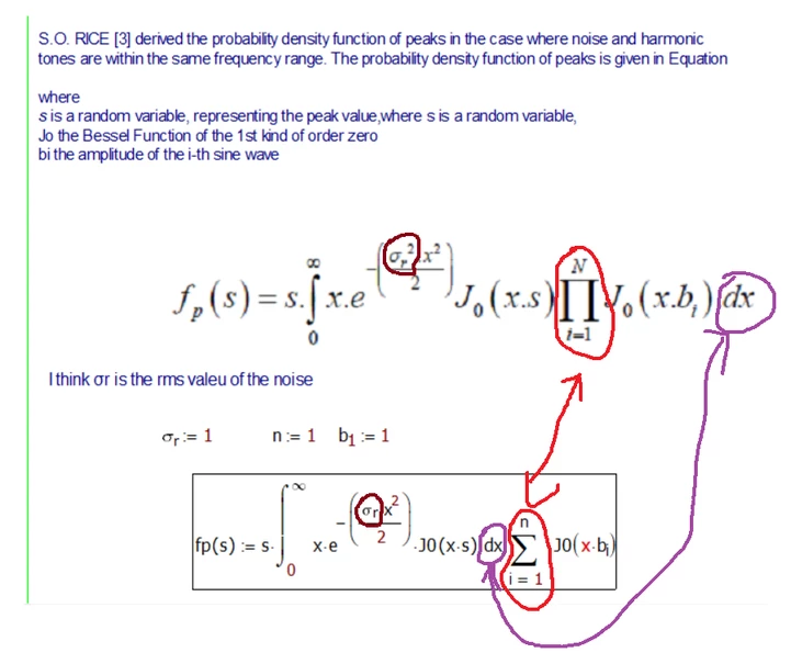

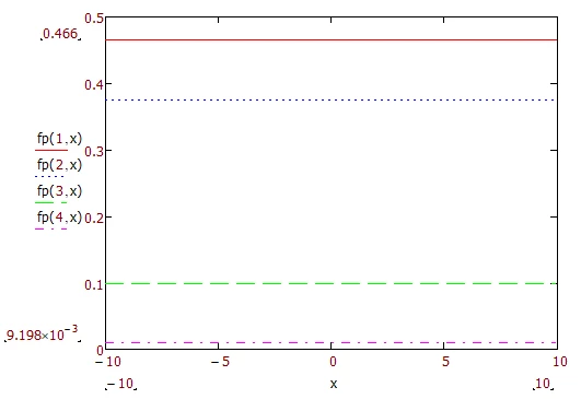

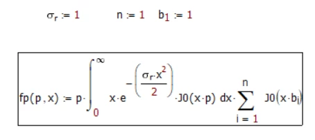

JXBWk14-AlexandriteAuthor
March 16, 2021
Thanks a lot for that. Appreciated. Thanks also for the corrections!
I frankly do not know what I am looking at so I'll take it as face-value
