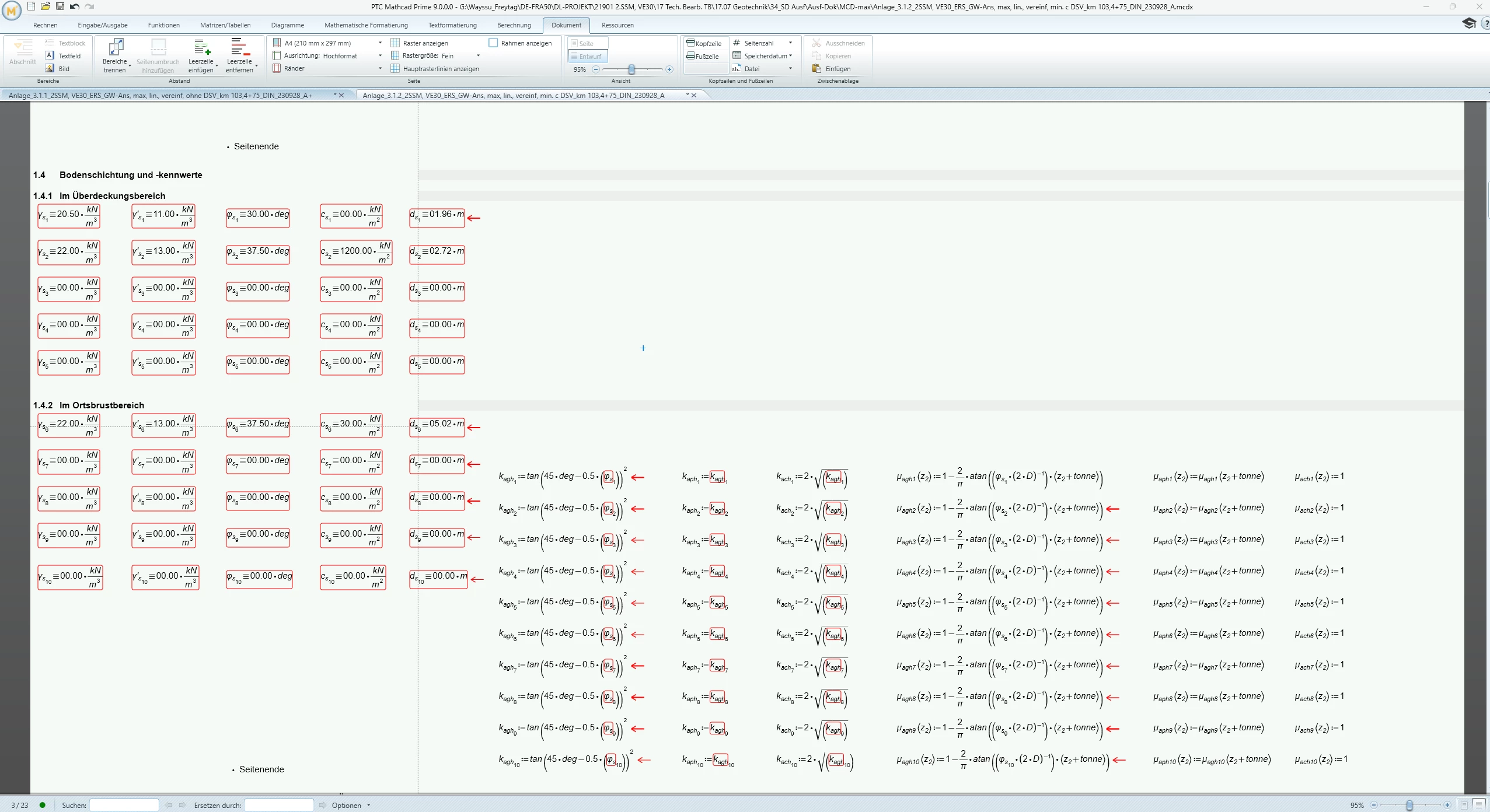

I converted a file from MathCad 15 to MathCad Prime 9. After the converting was made, MathCad Prime 9 is marking some of the variables with red Box saying that this variable is not defined (See screeshot). I noticed that the Problem is that Variable contains two level of subsripts and Mathcad Prime 9 cant see the second subscript. As a result all Variables will be seen as only one variable and not multiple diffrent variables.
Can someone help me please? Thank you

That variable ds3 is defined, but it is 0 and forms the denominator of a quotient. Klick on the variable encircled in red to see the actual error message. It says division by zero.
Changing the Mathcad file before conversion seems like a smart idea, mainly because the interface of Mathcad is much faster than that of Prime. However due to different fonts used in Prime w.r.t. Mathcad, you may still have some work to do after the conversion.

I think Prime can see the 'second subscript' (which is an index, by the way. Not that in
you have the 's' as a (literal) subscript, and the '1' as an index).
I think that the problem in your sheet lies with the fact that you use (too) many global definitions. You should use global definitions ( the ones with three bars), only if you really cannot do without.

Thank you for your answer. I changed most of the globale definitions (the ones with three bars) with (:=).
What I can't understand is why in some places:
and
the two Variables ds1 and ds2 are regognised, whre on the other hand:
ds3 is not defined.
I also attached the MathCad file in my reply (you can find it on page 3/10). Thanky you very much for your patience. your help is much appreciated.
