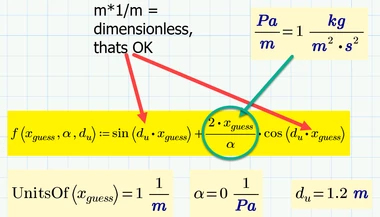

I am trying to generate roots using Mathcad but I guess I am unable to define the index properly. Please help me as what can I do to solve. My version is Prime 5.0

The problem is the equal sign after the definition of your function "a".
Delete it and it should work.
But now you get a unit mismatch because something with your function f is wrong.
You try to add unit-less (the first sine summand) and a summand which hast the unit Pa/m. This can't work.

Thank you for your reply. Yes, you are right the units of alpha should be per meter but still it does not work. I want my variable "a" to be defined such that it is a function of alpha, d, and x.
23-Emerald V
There is no problem, as long as you follow up all advice given. See attachment.

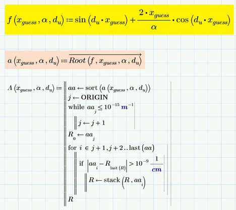

I think I found a solution.
Werner_E25-Diamond IAnswer
Vectorization as suggested above does the job as well and a bit more elegant, I guess.
Your program with "Match" and "trim" would throw an error if the function a(..) once returns a vector without a single value being 0 or less. You may use "try..catch" to cope with this or look at my suggestion below.
Worksheet attached.
