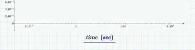

The Minor grid lines and Tick Marks do not appear at all when using Log scale. This seems to be a bug. I do not know how to submit a bug report, so if anyone does - please submit one. Looks like everything about Log scale under Chart component has not been QC’d.
I'm using the latest Mathcad Prime 6.0, but I believe this problem will also exist in Prime 5. If so, I can't believe this has not been caught during the last 2 or 3 years that they've put a lot of "focus" on graphing
There is also very limited control over the Log plot scale, and sometimes, when playing with Minimum and Maximum under User-Defined Range, the scale displays something completely weird - as shown in attached screenshot. This is probably also a bug.

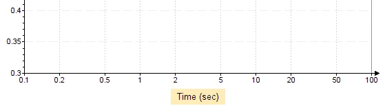

You're using the wrong plot tool, this is Prime 4 but the same is shown in Prime 6:
Note that the plot tool that was added in Prime 5 is a third-party component. It has other quirks besides not showing tick marks on log scales.

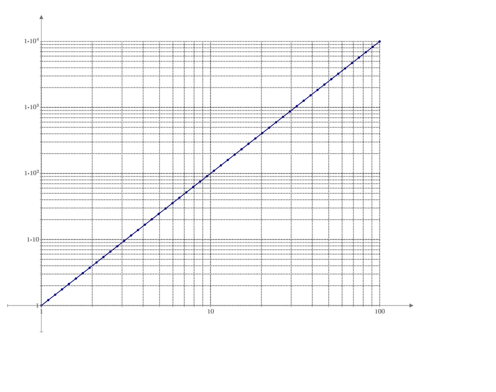

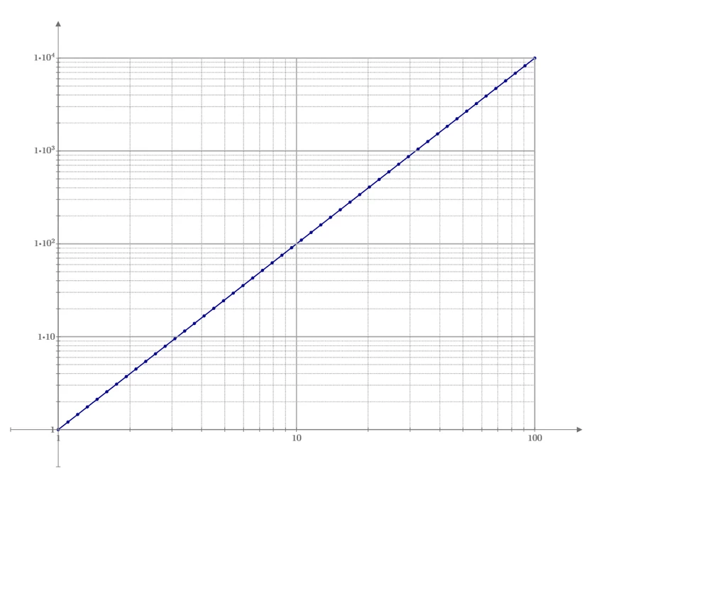

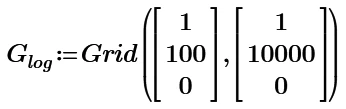

Mar 24, 2022 4:00 AM UTC
image.pngimage.png Using Grid function made by Loc and community members.
t.t.
