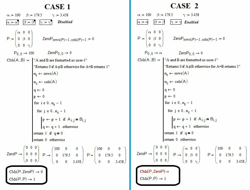

I have this little problem (see photo) that I can't solve ... in fact I want the "Case 2" to work too. How to do?

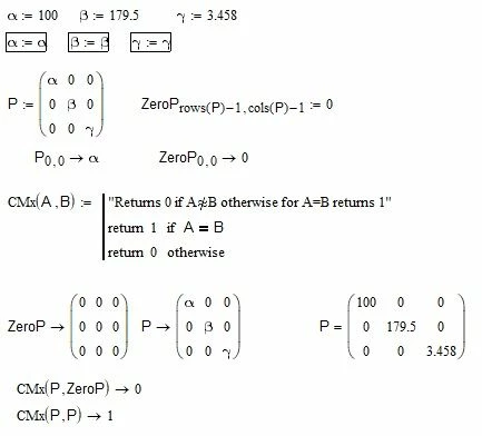

Do you think your problem is related to the 'user-1' formatting of these variables?
What do you add p-numbers for, I don't see the function actually use the value of p...?
I bet it's the if-statement that doesn't like to compare different symbols (in Mathcad 11 even comparing alpha with alpha is a problem).
Since you want the function CMx to output a 0 or a 1: What if you evaluate the last two expressions numerically (=) instead of symbolically (->)?

Try defining CMx simply as:
CMx(A,B) := A=B

Thank you very much.
