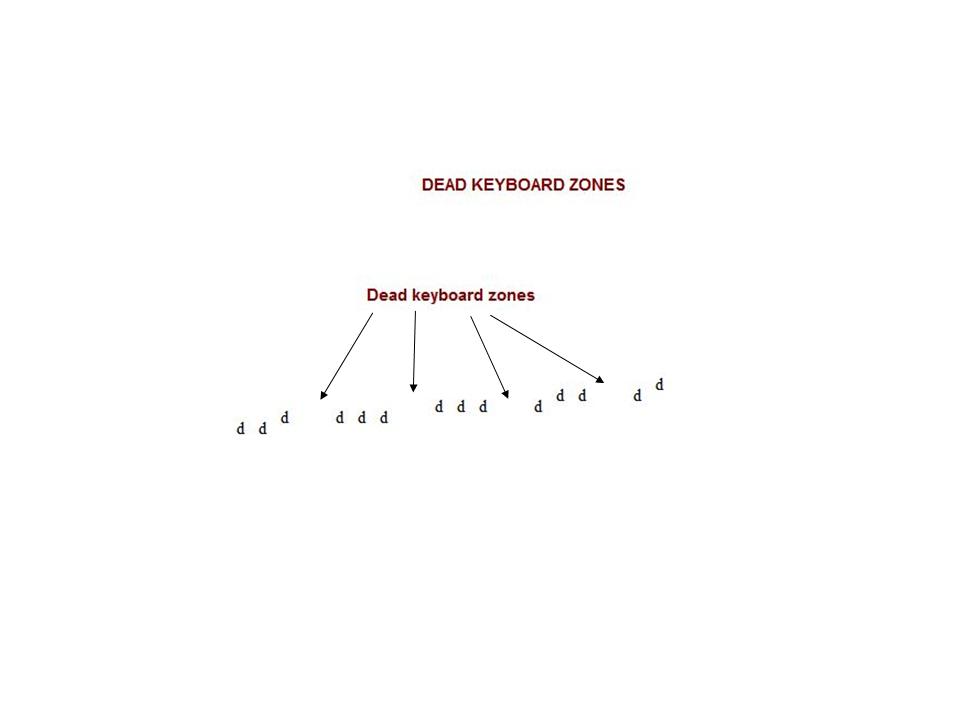

May 14, 2017
Richard--
Here ya go.  The Mathcad file is attached.  Also, a couple of images: (1) Mathcad 15 Version and (2) image file of where the dead keyboard zones are in the attached Mathcad file.  I doubt they will replicate on your system; nevertheless, here it is.  Thanks.

May 14, 2017
Well, M045 is the latest release, and you are correct that the dead zones do not replicate on my system.
I have never heard of this problem before, and I don't think it's really a Mathcad problem. There's something else on your PC that is causing this, but I have no idea what that might be.

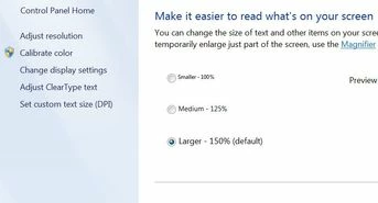

August 30, 2017
This was the issue with me.  I have 4k monitors and so months ago I had bumped up the font size to CUSTOM DPI 170%
When I switched to 150% thankfully the problem was solved.   I should have looked into it months ago, but I just used Prime 4 express instead.  Good day for me.

February 28, 2019
I know it's been a long time; however, your suggested fix did the trick for me also.  I did a custom font size to 120% and that worked because the built-in 125% still had the problem for me.
Thanks much.
