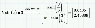

At the moment my students work with sin, cos , tan. As simple equation the should calculate the intervall where  5sin(x) is at least 3.
In Prime 5 one gets the (first) 2 solutions at once: prime5.png
But in Prime 6 there is only one solution:  prime6.png

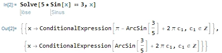

BTW: a good CAS like Mathematica gives all of the solutions ....
Sadly we cannot use this in our schools (no money ...)

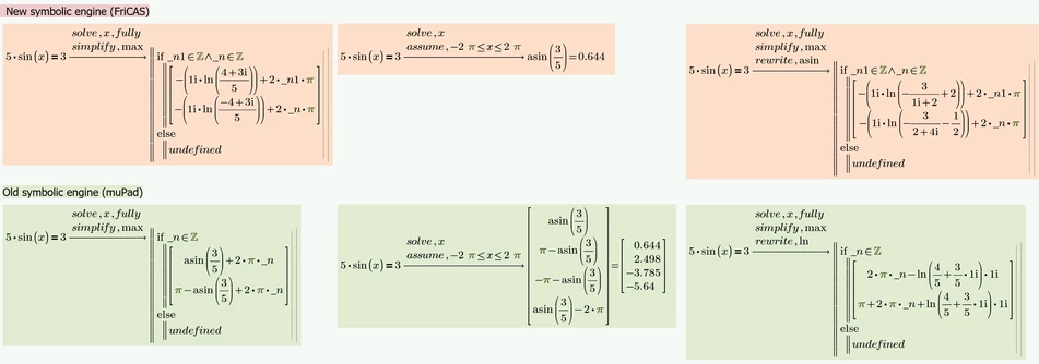

Below you can see the result of the "fully" modifier. As you can see even the new engine gives you all results but in a weird and (for your purpose possibly) unusable way. The new engine also ignores the "assume" modifier.
While we can talk the old engine into displaying the result in a similar way as the new one using the "rewrite" modifier, it unfortunately does not work the other way round - the new engine will not display the result using the "asin" function.
