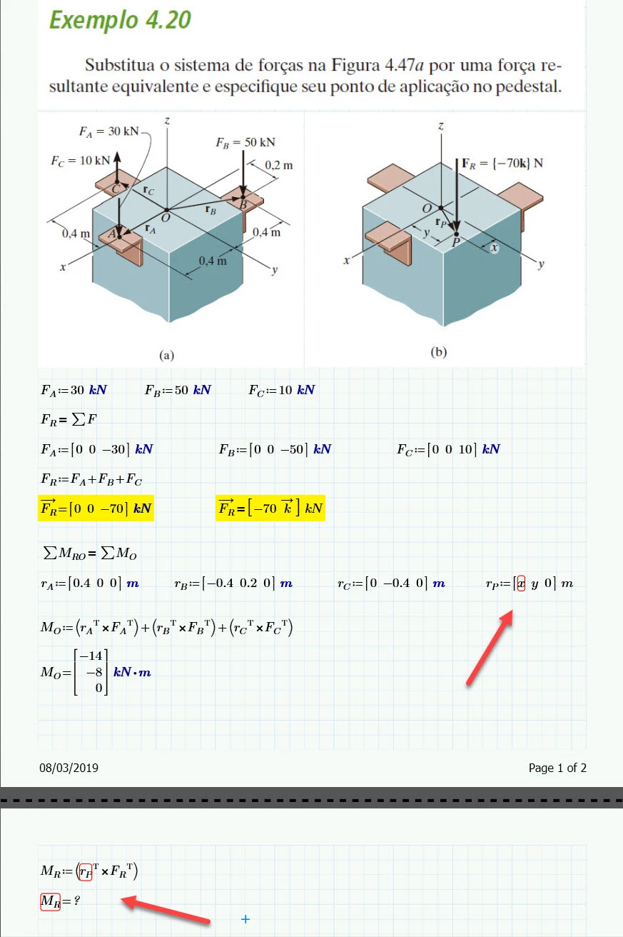

Good afternoon group friends, I am a beginner in Mathcad, and I am not able to finish a static problem, if you can help me, thank you very much.
Werner_EAnswer
What did you expect? You have not defined x and y so you cannot expect a numeric result.
You may let Prime evaluate symbolically, though.

7-Bedrock
Follow the file in jpg

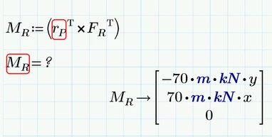

7-Bedrock
Werner, why the final answer did not show in "m", what I'm missing here. If you had to solve this problem through vectors would you do the same thing I did?
23-Emerald V
That is due to your definition. You defined rp as rp:=[x y 0] m. This means that x and y, like 0 are just numbers, without units. I would be rp that contains x m, y m and 0 m.
If you're interested, you might try to find out what happens if you define rp as rp:=[x y 0] and then solve x and y.
