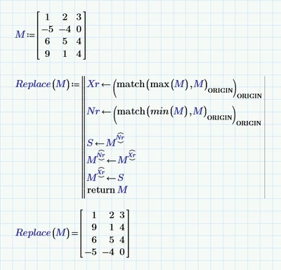

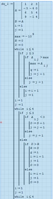

Hello, I need some help solving this problem:
Given matrix A(n,m). find the row with the most negative elements and replace it with the row with the largest element of the matrix.
Thanks!

November 23, 2022
i tried this sollution but its too long anyone can size it down ? 😄
November 23, 2022
got the awnser wich is correct but too long or there is another way of doing it?
November 23, 2022
You post this in a Mathcad forum, although it looks like you're using Smath studio...
Anyway, A Mathcad Prime program to do what you want is:
A Prime 8 file is attached.
November 23, 2022
Thank you u did it what was written but way to advanced is it possible maybe to do with if's/else 😄 i believe u can just do with  1 or 2 cykles but i have no idea how.
