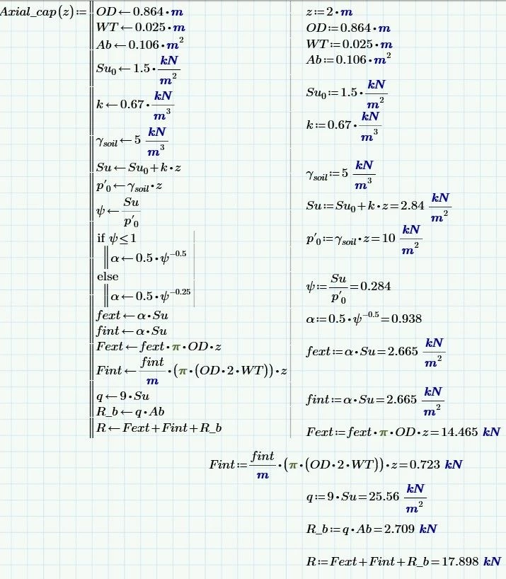

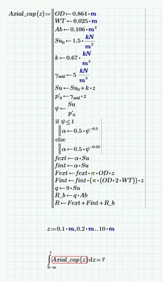

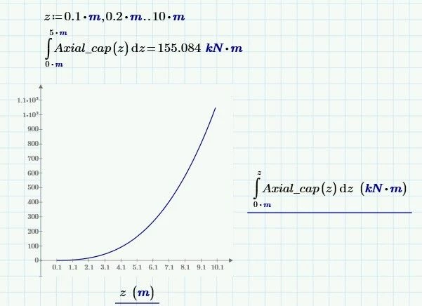

Hello, I'm having a hard time understanding units in Mathcad. I'm trying to plot an axial capacity vs depth after integrating the Axial_cap function with different depth. It works without when i have no units, but it shows an error : "These units are not compatible". I don't understand what's the problem.

Fint is wrong units?

Thank you, it was obvious but i didn't saw it. Didn't know you can see unit like that, thank you for the help
