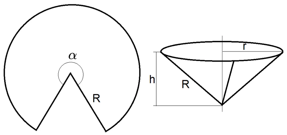

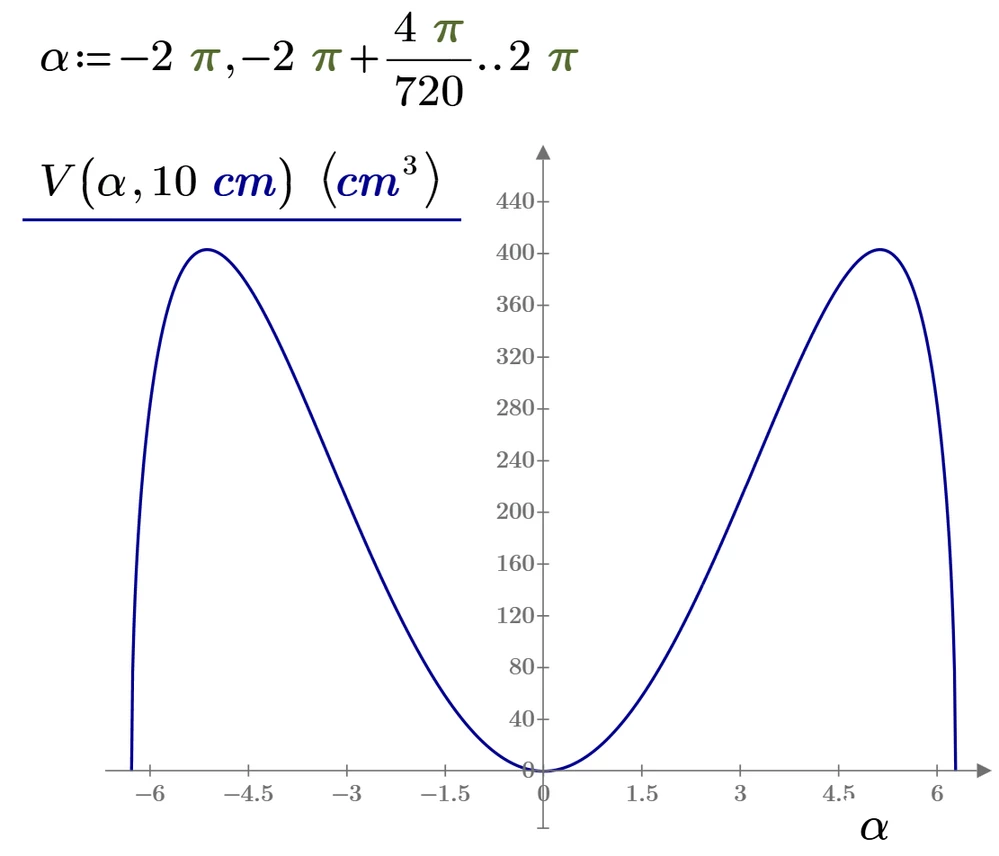

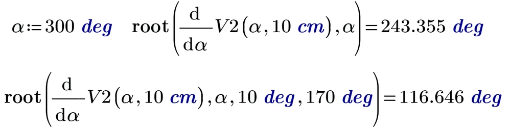

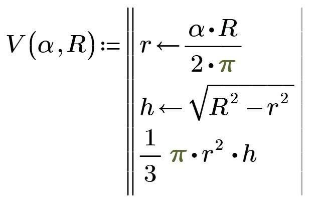

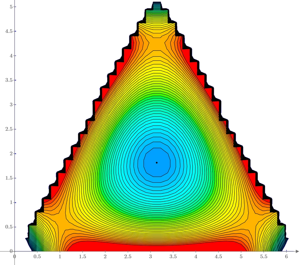

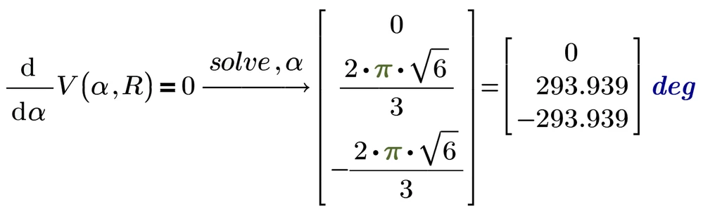

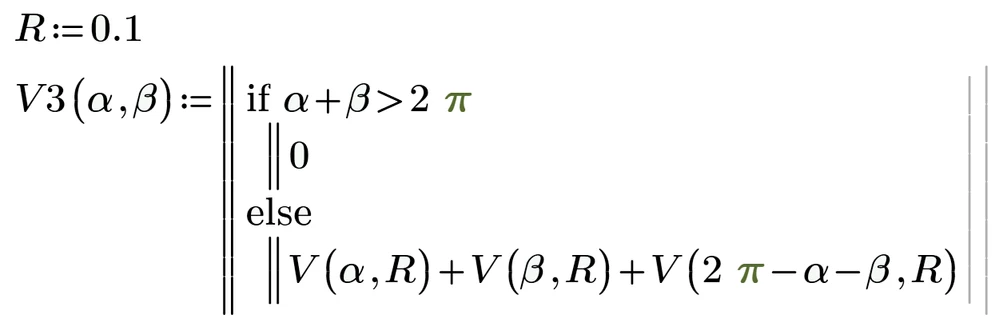

Here we have tried to find a symbolic solution for the problem of two cones.

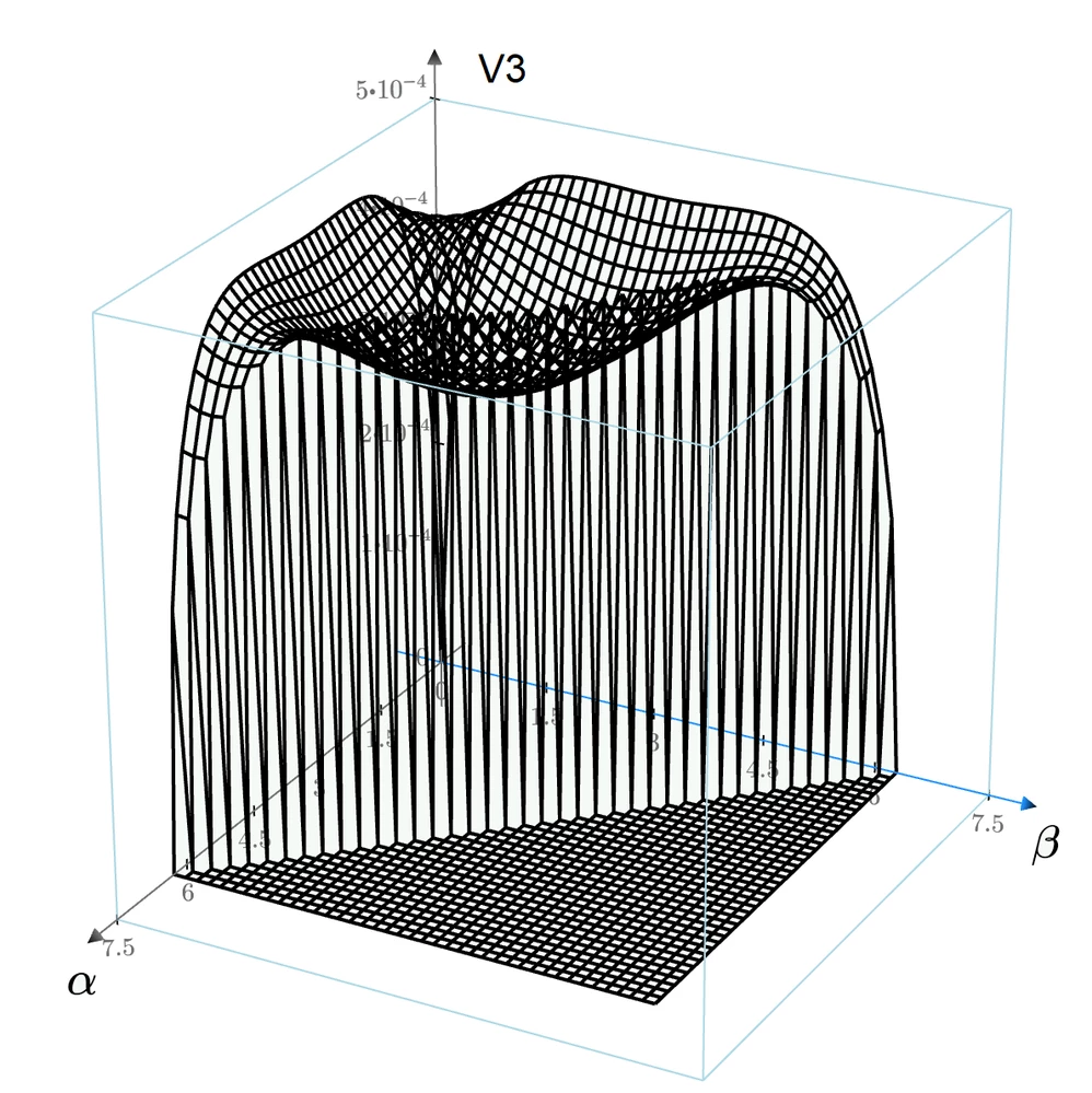

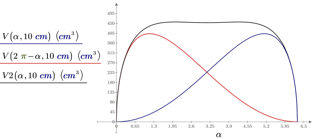

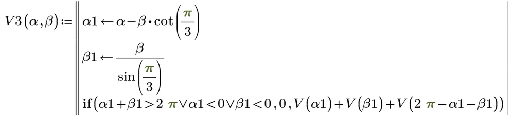

But we can cut out three cones from a round billet!
We can show with the help of graphics and numerical mathematics that the third cone is superfluous - the maximum total volume can be only for two cones.

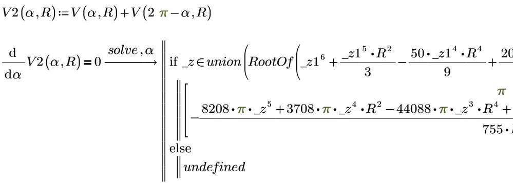

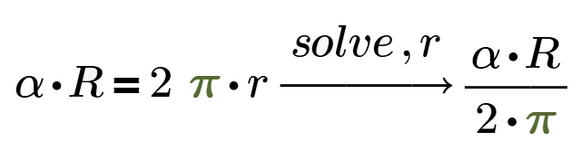

Can we show this using symbolic MATHEMATICS?
See please pics and Mathcad Prime 5.0 sheet.

Here must be the triangle diagram
