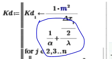

Hey! Im having big problems with the addition. In the first picture you can se how 1/alpha is added to 2/lambda without 1/alhpa being under the division. This is my problem I'm trying to recreate it but nothing works. The second Picture is how i manage.

Type the following:
1m^3<space><space><space>/1/a<ctrl-g><space><space>+D<ctrl-g>x[i<space><space>/2<space><space>/l<ctrl-g>

The first picture shows how 1/alpha is added to ...... not 2/lambda ... but (x1/2)/lambda !
{Which should be equal to x1/(2 lambda) }

Thanks for the fast reply! I tried do as you say but in that case 1/alpha is added to entire x1/2/lambda wich is not what i want.. 😕
Compare pic 1 to pic 3 i Believe youll see what i mean

Type the following:

Thank you sooooo much!!!!!!!!
