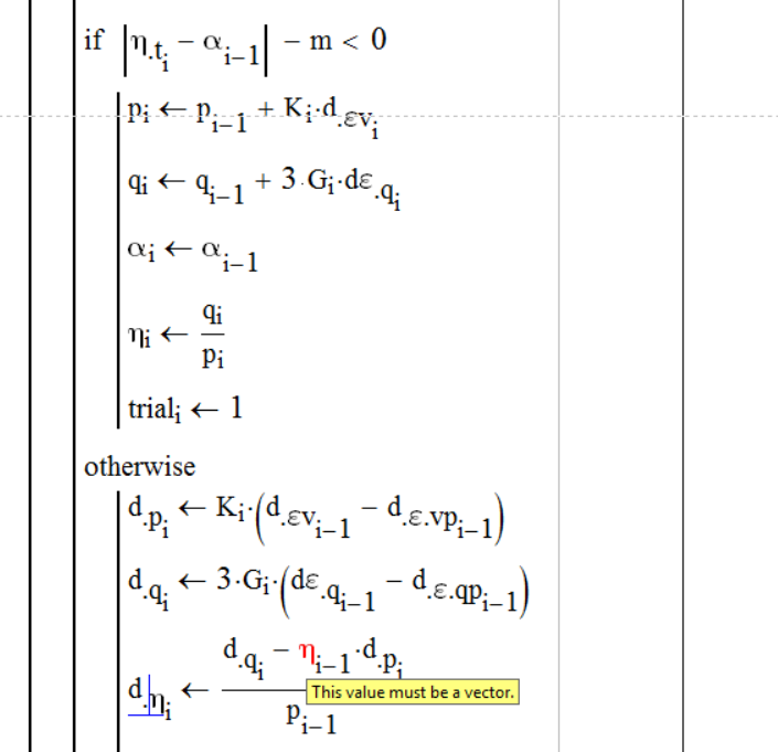

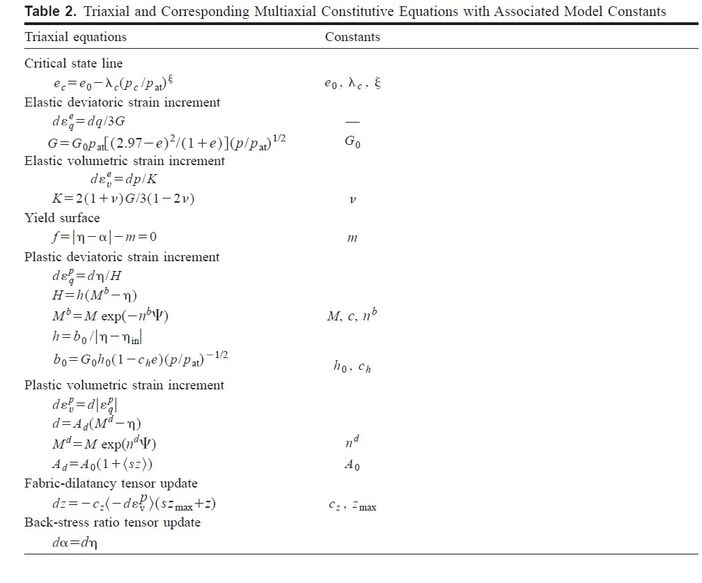

I am new in coding with the Mathcad. I am trying to code a model related to civil engineering (geotechnical engineering), but I have faced several problems. I think the problem is not that much hard, but I couldn't solve it. I wonder If somebody could take a look at it and give me some hints about that. I have attached my file as well as the picture of what I am trying to code.

You're using a variable eta with a subscript i-1. This means that eta must be defined AND must be an array.
Well eta is defined, and is an array PROVIDED that the if-statement (at the top of above picture) is true. Apparently that is not (always) the case.
Either make sure that the if-statement is executed, or provide some other way of generating the eta array, or find a way to execute the 'otherwise' without needing the eta array.

It was great. I modified my code a little bit, and I faced another problem. It says: " Found a number with a magnitude greater than 10^307 while trying to evaluate this expression." How can I deal with that?

You're raising e to the power n.d times psi. either n.d or psi, or their product is too big.
