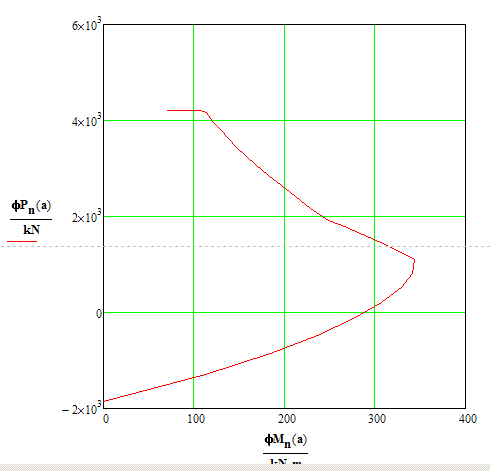

And what kind of plot DID you expect?
You have to give us more information, I guess.
Did you expect something like this?
Werner_E25-Diamond IAnswer
gbayazid1-VisitorAuthor
Yes,
Thank you very much.

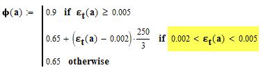

Please I have the same problem with column interaction diagram but using mathcad prime 3.0. I dont understand why the xy plot does not want to be created. I am afraid of dont know how to convert because the tutorial I have followed was done in mathcad 14.@correct answer
