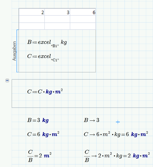

Hello to everyone,
I came here with a problem, namely when I use "explicit" function in "easy" way(just after input some data) everything works well. But if I introduce some data from excel file using output place the program has problem and doesn't want to show any units after using explicit function.
How to deal with it and get a value with unit? I enclose Mathad file (problem on page 2/2).

Thats strange, indeed.
Looks like you have found a bug in Prime. Units added in the Excel component are not recognized by the symbolics while.
A workaround is to add the units below and after the Excel component (maybe in a collapsed region).

Very strange indeed. The symbolic processor is identifying the unit and then stripping it by dividing by the base SI unit. Most certainly a big and need reporting.
Guess the problem is the Excel component, not the symbolic proc.
