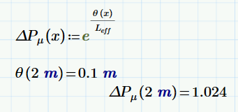

Sorry don't know how to attach the file ... This is the equation I'm trying to write. I know you know how to do it, trying to get the
range of variables for all the values of x.

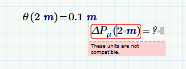

Looks like there's some bigger problem when calculating e to the power of some variable rather than number. Any ideas?
23-Emerald I
June 2, 2017
Units for theta are meters.  You can't raise e to a power with units.
can you do this?
sturunen1-VisitorAuthor
June 2, 2017
Fred Kohlhepp,
Thank you so much! The problem was with the units. I've been really struggling with this so it's a relief.
