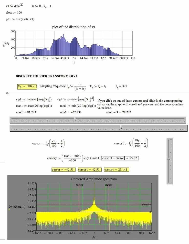

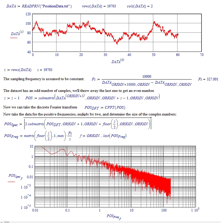

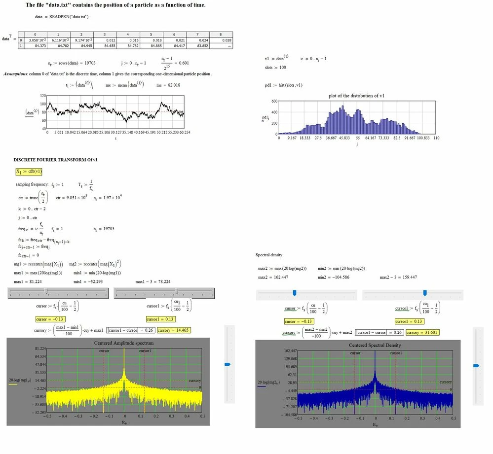

I have a data that contains the position of a particle as a function of time. When I apply the fourier transform I do not get any frequencies however through the time position graph and the position histogram, I can see that the particle has a position around which it oscillates. I also need to calculate the power spectral density (PSD) as a function of frequency. Has anyone ever worked with something like that?
The original data is attached.
Thnak you.

Something like this...?
23-Emerald I
March 30, 2019
Unless I have forgotten, the first term in a CFFT is the steady value (equals the mean.)  The first frequency should then be zero,  And the magnitude (except for the first term) should be doubled.
March 30, 2019
I took off the first element, kept the remainder of the first half of the spectrum data and doubled that.

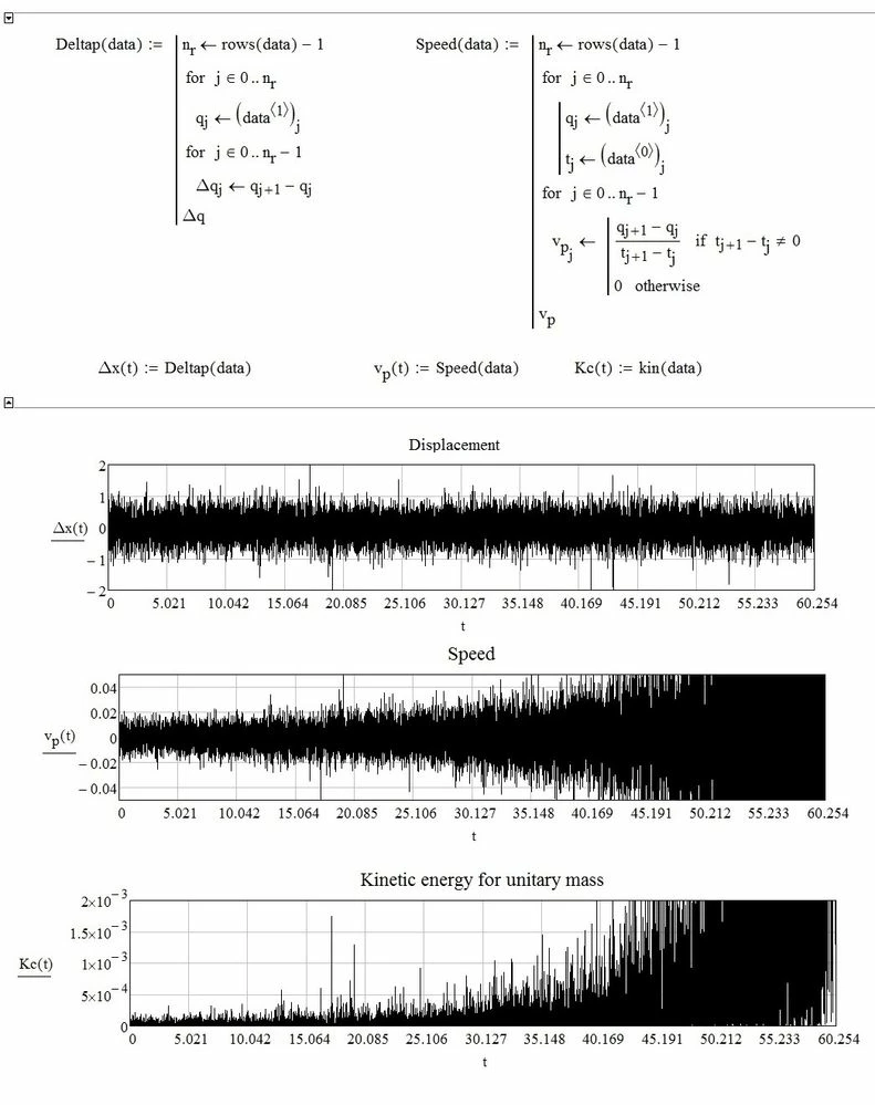

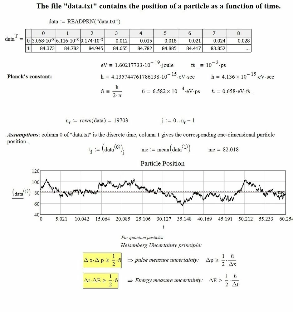

March 30, 2019

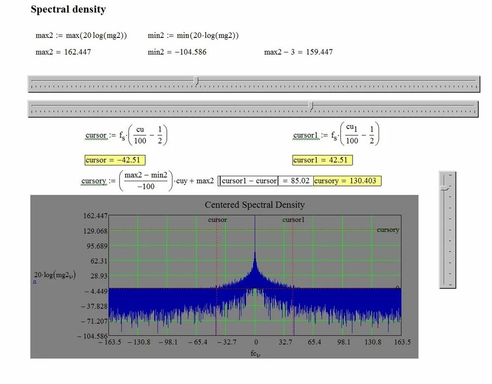

This is all I can do with the data I have:
April 2, 2019
for U. M. 01.jpgfor U. M. 02.jpgfor U. M. 03.jpgfor U. M. 04.jpgfor U. M. 05.jpgfor U. M. 06.jpg

April 1, 2019

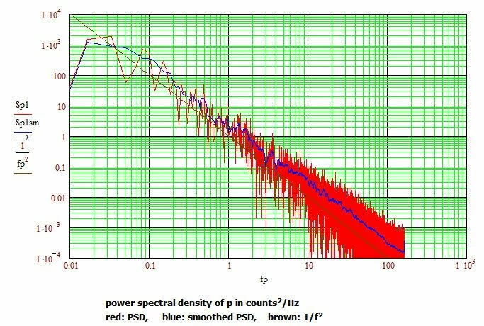

The particle does move back and forth about its average value (~82). However, it does so essentially randomly, with no single discernible frequency. Luc has done the essential calculation. However, there is a scale factor that needs to be applied in order to get the correct quantitative values for the power spectral density (PSD). For the signal p(t) with N samples, let P = CFFT(p). Sp1, the single sided PSD is defined for f=0 to fNyquist, and is given by
The factor of 2 sums the power for both positive and negative frequency components for f>0. Since all of the DFT routines, including CFFT, deal just with the data vectors, there is no information about the horizontal scale, be it time, distance, or something else. The N/fs factor provides the correct scaling (with CFFT) so that the result can be interpreted as a power spectral density. If the units of the data p are mm, then the PSD will have units of mm^2/Hz.
The plot shows my calc of PSD, a smoothed version, and a reference line of 1/f^2. The PSD follows the 1/f^2 behavior quite closely over the full frequency range. MCD v11 file and pdf attached.

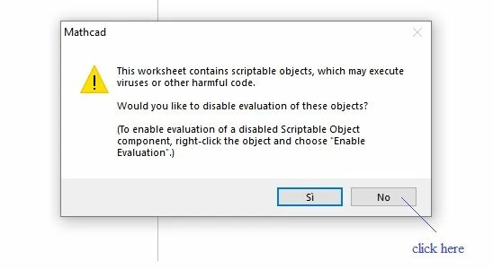

I don't see any anything in the attachment. Is it an image? Please try again.
Lou
