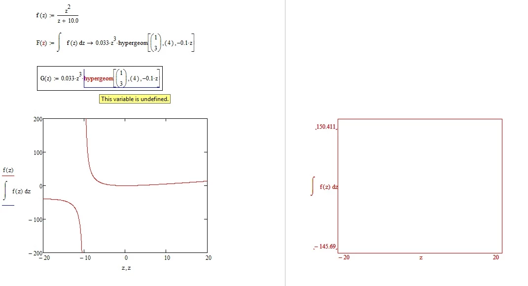

I have a problem with an integral. Symbolic evaluation resulted in a "hypergeom" function. The problem is Mathcad 15 does not recognize its own function "hypergeom". Is this a bug? Does anyone now how to deal with this problem? I am interested in solutions for 'z' larger than -10 in this particular example (away from the singularity).

Its not easy to understand what  MC is doing with these functions,
the attached does plot the result of the hypergeom function using values saved in an array.
Its not pretty, but hopefully you can get sufficient information from it

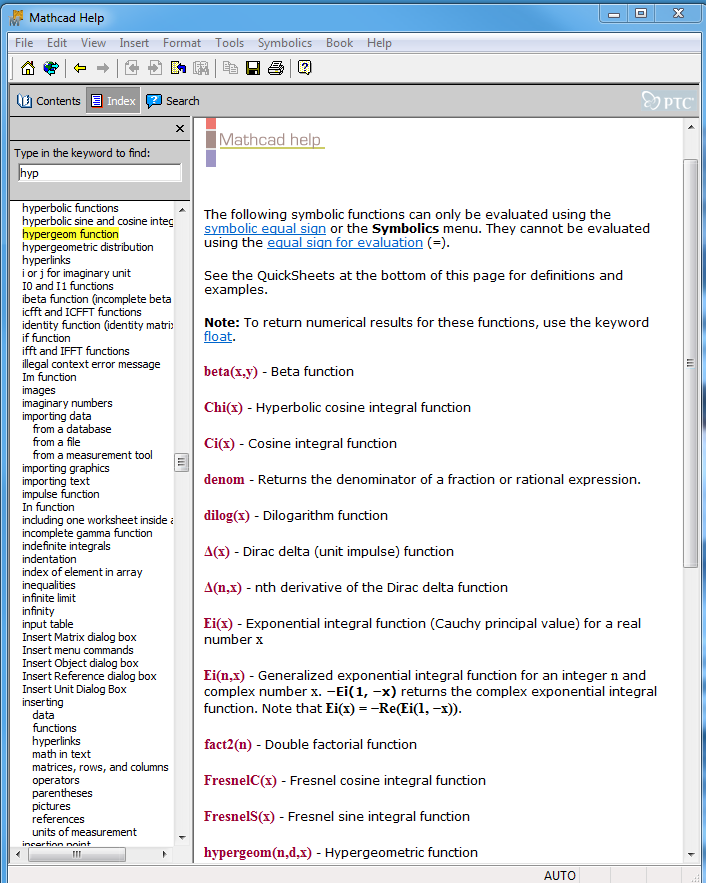

HyperGeom is one of the symbolic only functions that MC15 supports, see the help (F1):Capture.PNG
It does say that the 'float' keyword can be used to get a numeric result for the function.
The quick sheet gives a suggestion to verify the results that you get.
