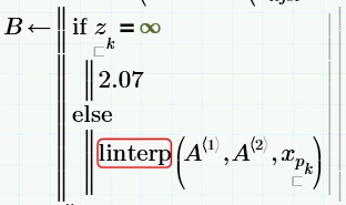

In Mathcad Prime 9.0.0.0 I am able to calculate the value of the program. In Mathcad Prime 10.0.1 I get the following error message:
What is happening? The two attached calculation sheets are identical.
When I define each step in the program seperately in Mathcad Prime 10.0.1, it does give me the right answer.
Also, when I replace all the infinity symbols by say 10000, the problem still arises.
Hope you can help me!

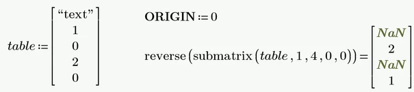

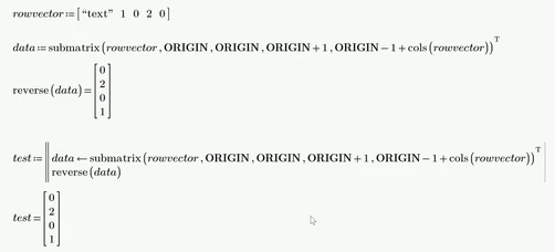

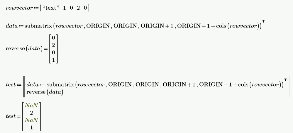

Additional note:
I tracked down the bug to this simple example:
Obviously every zero is replaced by a NaN.
Both, "submatrix" and "reverse" have to be applied for the bug to show in Prime 10.
The attached worksheet is in Prime 9 format, so you can test easily that it works OK in Prime 9, but fails after recalculation when loaded in Prime 10.
Prime 9:
EDIT: Even simpler without programming and transposing

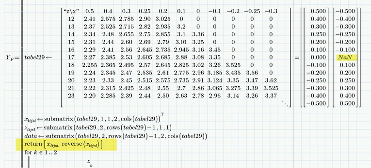

image.pngin table29 makes the error.

As @ttokoro  found out, the text "z/x" in the top left corner of your table causes the problem. If you replace it by any number or by a NaN, the sheet works in Prime 10 as well.
I guess its a bug in Prime 10, as this text is effectively removed by the various submatrix expressions is is never in play during the calculation.
So the program should work OK in Prime 10 as well but it doesn't. You should file a bug report.

I am pretty sure now that its a very strange bug!
I looked further into it and finally found the a bug in reversing your vector x.list introduces a NaN out of the blue instead of the correct value 0. This NaN then the causes the error when this vector is used in "interpolate" (first column of Matrix A.:
Needless to say that in Prime 9 the output is correct (a 0 and not a NaN).
As a workaround so you are not stopped at your work you can replace the text "z/x" by a NaN, but this bug sure should be reported.

Additional note:
Prime 9:
