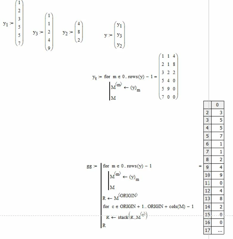

mzarrabi1-VisitorAuthor
Thank you for your response, but I want to use it in a loop in a way that regardless of the number of vectors (y), the function can automatically do that. For example, if there are 10 different vectors (y), there would be no need to change the function to work. I hope you find my explanation clear.   Best.

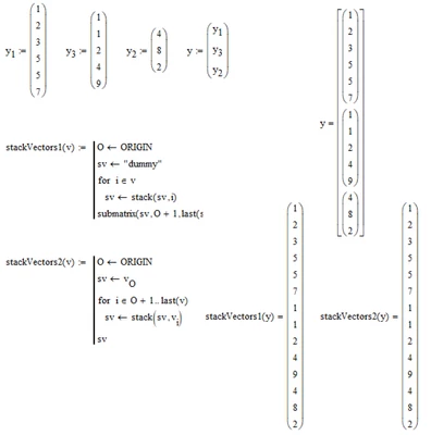

Werner_E25-Diamond IAnswer
How about this:
