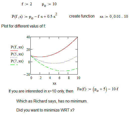

I am building a program which manipulates a bunch of 1x400 vector arrays then integrates 2 of the arrays (Runge-Kutta). The final result of one of the integrations is then minimized with respect to frequency. No problem with minimizing a simple analytic function, but I must have a bad syntax here.
So I built a simple exercize below to make it easier to see my mistake.
Given
Where am I going wrong?
Thanks, Al

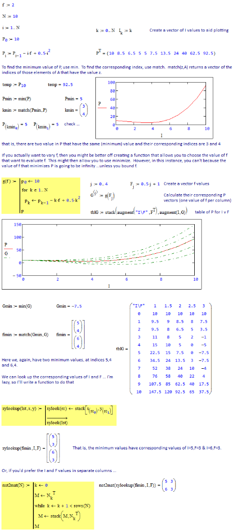

The error occurs becaus temp has to be a function depending on variable f. p(f):=....
In your case temp is a simple variable and so cannot be minimized.

To minimize P with respect to f, P must be a function of f. That's easy enough to do, but then it's clear that there is no real minimum: as f increases, P decreases:
Maybe you just made the example too simple though, and your real function does have a minimum. In which case you can find it with minimize(P,f)

Are you really trying to find the minimum of P with respect to f? or just where the minimum is for a given f?
