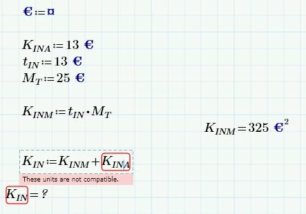

I have a problem with this sheet.
I am trying to multiply an add some things with each other. But i get a error.
Can you guys help me ?

The error message is quite informative, I think.
You multiply two variables of unit "Money" and so you get a variable of unit "Money"squared, whatever that may be. You see the €² in your screenshot?
Then you try to add simple "Money" to that "Monay²" - this has to fail.
Think of meter.
Can you add 2 m² + 3 m ? Sure not - you can not add an area and a length. What should the outcome be?
The same applies to € + €² - they are not compatible and Prime correctly refuses to add them.

bgarmann1-VisitorAuthor
May 18, 2016
Thanks for the update. It's working fine now
