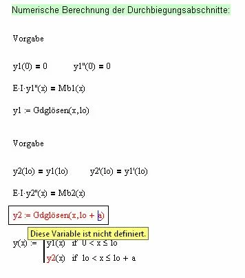

I want to calculate a deflection of a beam with Odesolve in MC15.
The deflection consists of two parts: y1(x) and y2(x).
I could solve the y1(x), but when trying to solve y2(x), i got an error-message:
"this variable is not defined"
You can see it near the end of the sheet.
The boundary-conditions are: deflection in the bearings are zero, the bending moments as well.
What am i doing wrong here?
Thank you for your help.
ps.: The MC15 File can be uploaded only as a zipped file.

You can't use the prime symbol (Ableitungsstrich) for the derivative of y1.

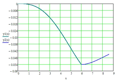

 But I don't think that the result is correct. When I look at what the value of the first derivative of y1 at lo (6) is, I sometimes get an error (which I would have suspected at the end of the interval)Pic3.pngand sometimes it will (upon recalculation) evaluate to 0.Pic4.png
So I see two options, Either let the first odesolve block up to lo+0.1 (or something like lo*1.01) or you change the initial condition in your second solove block to y2*(lo)=y1_diff(lo-0.1) or something similar.
This gives a more plausible result:Pic5.png

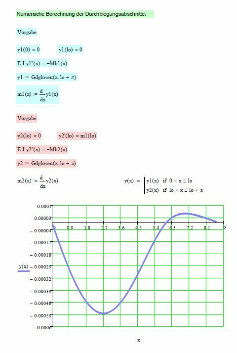

vlehner1-VisitorAuthor
July 11, 2017
Vielen Dank Werner,
Ich glaube das war der Knackpunkt mit dem definieren der Funktion für die erste Ableitung.
Auf die Schreibweise mit dem Ableitungsstrich wäre ich so schnell nicht gekommen.
Jetzt gilt es die Übergangsbedingungen sowie die Grenzen richtig zu finden/festzulegen.
Way to go!

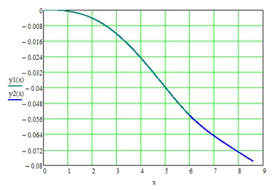

July 11, 2017
...now it's done 🙂
THX Werner!

Mathcad will have issues with Odesolve when the constraints aren't "initial conditions."
Attached is a finite difference solution.  You need a stronger beam!
July 12, 2017
Thanks Fred!
