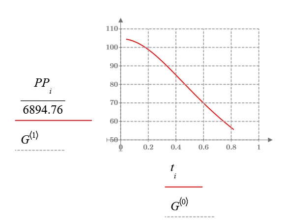

With a noisy signal like the one you show, the numerical derivative sure is useless. If you know which kind of function type you expect, you may try a fit using genfit() or a solve block with minerr.
Otherwise smoothing sure might be an option. Be sure to also look at the functions available in the Data Analysis Extension Pack (Help->E-Books).

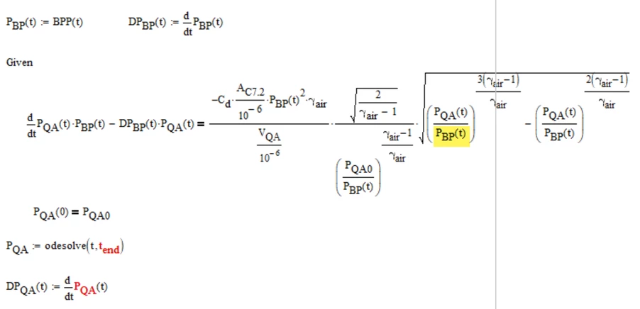

Jul 21, 2023 12:06 PM UTC
The error in the new sheet is not "variable undefined" as you initially wrote, but rather "too few initial conditions"!??
Some things I  noticed:
You sure should put
in before solve block and don't let the solve block solve for P.BP
You have only a first order ODE so you can't use P.QA(0)=... and P.QA'(0)=... as IC. Delete the latter.
There is no IC for neither DP.QA and DP.BP.  And there is no ODE for both of them , too - guess odesolve does not like this?
Anyway, I guess all you have is just one first oder ODE for P.QA and I thought hat the approach shown in the picture should do it.
But I get a rather meaningless error message and don't know what the problem may be.
I also noticed that when I just omit the one highlighted P.BP(t) (replaced it by 1), the solve block seems to work OK.
Have no clue how to fix that at the moment but I attach the modified sheet anyway
