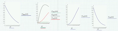

I am working in mathcad prime 3.0 on an assignment and I am modeling a Trickle Bed Reactor (plug flow behavior). I have set up the mole balances, from which I know by now that they are correct. I use the odesolve function to solve a set of differential (and algebraic) equations. However when I plot the results I do not get the results I want. Attached is the file I made. I made a plot with the liquid concentrations of the components. I see only a difference in the concentration of A and I am wondering what I am doing wrong, because i should also a difference in the concentration of B and C.

Maybe I am forgetting something trivial, but i'm am stuck for a while now. Any help would be appreciated. To be clear: I am wondering why i don't see a concentration difference for component B and C in the plot.

23-Emerald I
March 22, 2018
Replace
with
and get

23-Emerald I
March 22, 2018
Replace
with
and get
