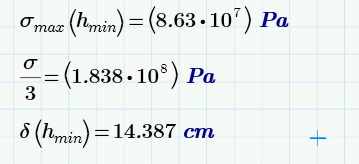

I'm having trouble programming a while loop for to determine the optimal height in a beam deflection problem for school. I keep getting the error, "These units are not compatible," but if I remove all of the units I get the error, "This expression is divided by zero. It cannot be computed."
Attached is the program I am working with.

Hi Alex,
I think that you may have a problem with the logic of the while condition.
For the i=1 initial condition, the first condition is true, but the second is not and therefore the while loop does not execute.

You have h as Stefan–Boltzmann const:

If I change h to ht the same error message still appears.

Tha variable h must have a correct value before start the loop.
Chek it please!
