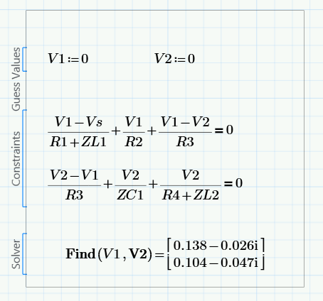

Hello everybody. I have been trying to solve a simple RLC circuit for some voltages (V1 and V2) using Mathcad Prime 2.0, with no luck. I have tried using optiuons such as:
-Solve block
-Symbolic evaluation
-Find function.
The worksheet is attached. Any help/comment is appreciated.

You must insert a Solve Block - see attached.
Alan.

Thanks, Alan. In fact, I have used the same approach, but got an error message with find function. It appears to be functioning now

A solve block works fine when I try it. Here's an image, since I have Prime 3.0, which can't save a Prime 2.0 file (lame, but true).

Your sheet does not show any of those attempts, so it can't be said what you did wrong.
Using a solve block would require you to use the find function, so this are not different methods. It was already shown twice how to do.
Using symbolic solve (! not evaluation) will work, too, but is not the preferred method, I guess. You would have to put the two equations in a 2 x 1 matrix and then use the symbolic "solve, V1, V2".
You may even use the symbolics to get a more general symbolic solution in R1..R4, Vs,ZL1 etc.
While you are at it, why not adding proper units? Prime can deal with units so it would be a good idea to use units in your calculation.
