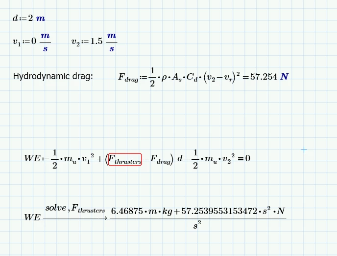

Hi everyone,
I solved for the variable Fthrusters in the equation WE:
The solution shows:
1° term unit: m.kg/s^2 = N
2° term unit: N.s^2/s^2 = N
Why does the solution choose to keep them as independent terms if they can be operated?
Even changing the units of the previous variables from N to kg.m/s^2, the 'supposed' solution remains unresolved.
Thank you.

The symbolics does not know anything about units and treats them as unknown variables. Thats the reason you don't get a simplified result.
You may assign the calculation to a variable and if you evaluate this variable numerically you should see the result you expected (you should check the option "Units/Constants in Symbolics" in the calculation options).
As you are just looking for a numeric result, you may consider to just use numeric methods. Prime offers either a solve block with "find" or the "root" function. Look them up in the help.
For further help you would have to attach your worksheet, not just posting a picture.

I attached the file below:
Case 1: It's ideal because it allows me to input the equations formally and expect Mathcad to solve for the variable.
Case 2: If I understood correctly, this is what you're suggesting; using numerical variables without units.
Case 3: That's what I'm currently doing, which is finding the variable directly by rearranging the equation. But it's not practical to do this with every equation.

No! I was not suggesting doing a unit-less calculation as in your Case 2.
What I was suggesting was to assign the symbolic result to a variable (F := WE ->(solve)....) and then evaluate that variable numerically (using the normal equal sign, F = ....).
As an alternative I suggested using pure numerical methods instead of using the symbolics.
And I sure won't suggest solving the equation 'manually' and use the derived result as in your Case 3.
Find a couple of suggestions, ideas and comments in the attached Prime 9 file.
