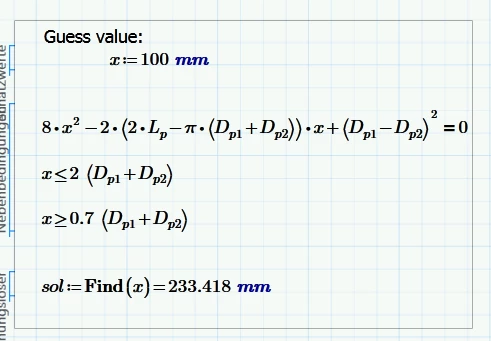

I am new to Mathcad,I have been using PTC Mathcad Prime 5 since yesterday.
I have a problem when I use solve and assume for this quadratic equation. All the variables have mm as unit. If I assume mm <> 0 then it works. The answer I am looking for is 233.41847464108950079 mm.
Ps. If I put = it shows the good answer (my bad, I was too frustrated about the if and else thing to try), but why does it show if and else?
