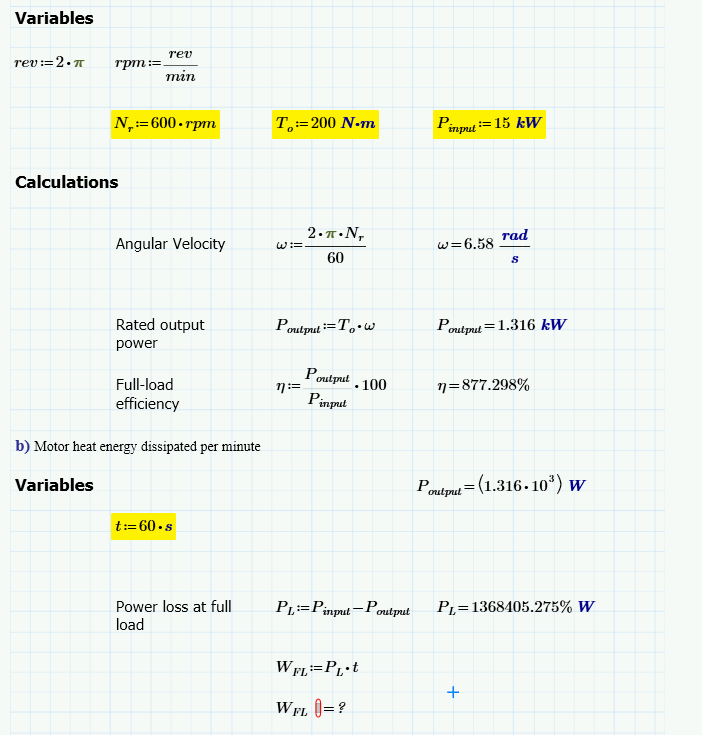

Hi
Trying to complete simple question on motors but can not get the formals to work in correct unit
I can not get
  • Nr be 600 rpm
  • Angular Velocity to rad/s
  • This basic unit error the follow down document to
  • Rated output power kW
  • and finally motor Full-load efficiency in percentage %
Can anyone help, see attached file
Thank in advance
November 10, 2015
Multiply N.r by rpm
