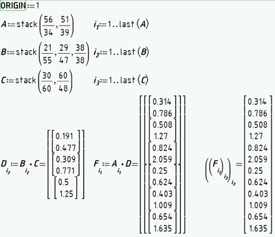

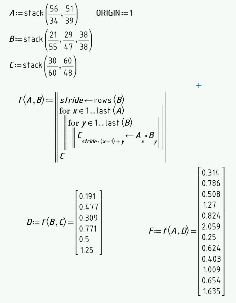

Problem with vector what equal to vector multiply
I succeeded calculate multiply:
But convert in vector "g" I cant do
And quastion: Do mathcad have any method to calculate this?
Like:

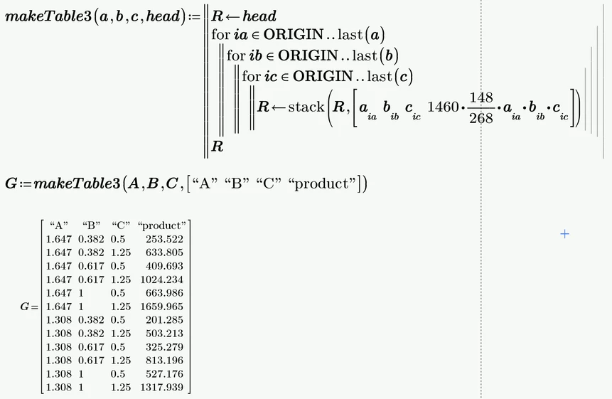

Oct 5, 2023 11:57 PM UTC
Would this help:
Or maybe you'd like a table so you see which values were used to arrive at the results
Prime 9 sheet attached
P.S.: Of course you may use the same function also for just two vectors if you provide as third argument a 1x1 matrix with value 1:
P.P.S.: You actually can achieve the desired result using the ranges you already defined, but I would not suggest doing so:

Yevg_Stef1-VisitorAuthor
Oct 5, 2023 7:48 PM UTC
In "primal" form it is look like this

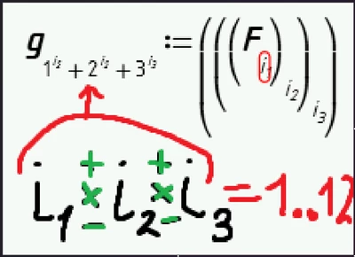

Oct 5, 2023 9:21 PM UTC
Oct 5, 2023 11:04 PM UTC
Maybe it help get answer for this task
I think this task is how to connect "g" indec with:
For undestand "full picture":

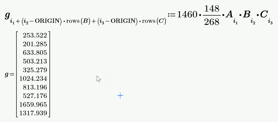

terryhendicott
Oct 5, 2023 11:21 PM UTC
Like this:
