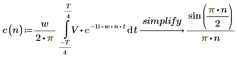

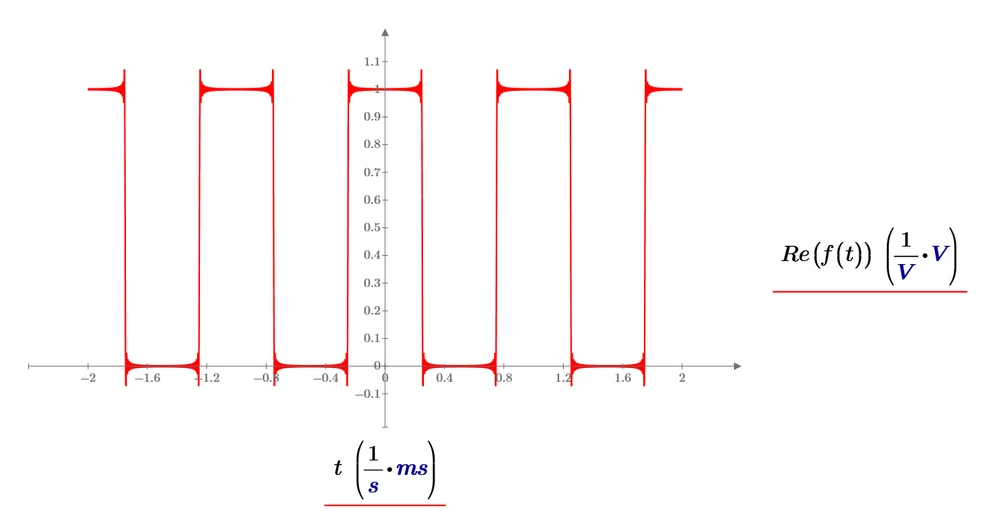

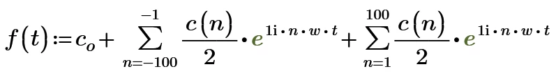

1. c(n) must divide by 2.

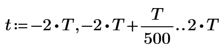

2. delta t should be more small.
