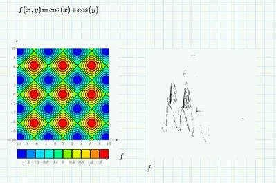

Here's a problem I saw on Dell laptop a while back and now have on my new desktop - a Dell running Windows 11.  I made a simple function of x and y.  It looks fine as a contour plot, but the 3D plot won't render.  Has anyone else seen this?
This is the only graphics related problem I've had with either machine, so it doesn't feel like a driver issue.
Thanks for your attention 🙂
Mark

It may be something you would like to report to PTC Support (again).
Have you ever heard again from the support back in 2022? Actually your problem wasn't solved and the latest 'news' in that thread is that PTC support is "working on it"    3D Plots in Prime 7 Not Showing on Screen
I have not experienced that kind of error and can't remember that it was already reported here in the forum.

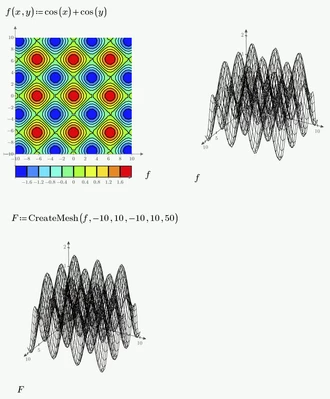

Does the effect occur with every 3D plot you make. What happens if you choose "Surface Fill"?
Does it help to change the number of points from the default 41 to something else?
Does it also show when you use CreateMesh() (maybe with other numbers instead of the 50?
Actually I am just poking in the blue as I have no idea what could cause this strange error (guess you already followed the usual IT advice to deinstall the software and install it from anew 🙂 ).
Given that you had a similar problem in 2022 with  a Dell, too, it looks like a very specific incompatibility but I can't imagine what could be soo different on a Dell machine...

When went back to try again, I added another sheet to a Prime session I already had open and it worked.  When I closed Prime and started again, the problem came back.  Weird.
Alas, changing the number of plot points doesn't fix the problem.  Neither does adding surface fill.  I contacted PTC about this problem when I saw it on my laptop a while back.  They followed up and then I never heard back.  I guess they lost interest.
