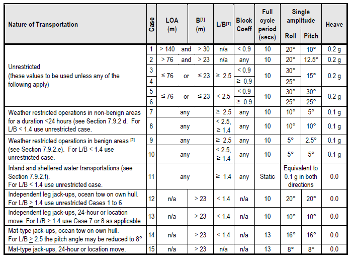

I am very new to Matchcad Prime 3. I am trying to do a programing which is given as screen shots below. I don't know it is the effective way of doing it. Please correct me if any of my calculations were wrong.
I am trying interpret the follwing table to Mathcad programming.
I have attached my Mathcad file which explains my calculations. Please help

If you want my honest opinion I would suggest against trying to automate this. I regularly use this standard and find manually selecting the correct case the easiest way.
