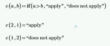

May I suggest using a function:
That way you have a reusable test.  Global variables should be avoided when possible and used sparingly.

As you have found out yourself, the global definition can only be used with constants, so what you tried must fail.
There is no way to put results on top (maybe with the exception of scripted components which are available in Mathcad 15 an below, but not in Prime).
One way I could think of is to hide the calculation in a collapsed region so it just looks like the worksheet starts with the results.

FredKohlhepp thank you for your response but what I am looking for is to place the result at the top.
Werner_E thanks for your response, well it seems that it is not possible in this version thanks anyway
