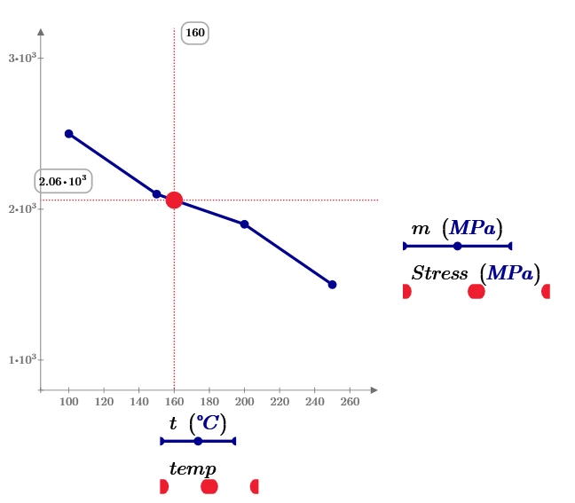

ttokoro
Jun 14, 2024 11:18 AM UTC
image.png f/ MPa for 2220 MPa line.
t.t.
