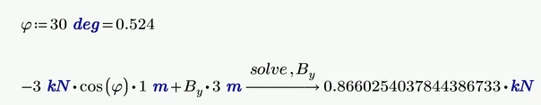

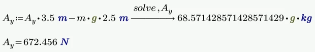

Hi everyone, when i got a new laptop and donwloaded mathcad again, im suddenly having different issues with it i didnt before. Like when using the solve function it cant give me the answer if i use units in 1 scenario. In the other it gives me the answer as "cos(30deg). Anyone knows if its something i can fix?
The one above is supposed to give around 673N.
This one is supposed to give 0,87kN.

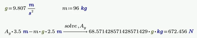

But even with the option active, the symbolics knows nothing about the relationship between different units or the definition of constants.
You see that the symbolics does not know how seconds and minutes are related or how the gravitational constant is defined. It regards all these quantities as independent unknown variables. But since the labelling as a unit is not lost when the appropriate  option is activated, the result expression can at least still be evaluated numerically (or saved in a variable).
The shortcoming that the symbolics cannot handle units is not new in Prime 10. It was exactly the same in all previous versions and was no different in real Mathcad (version 15 and before)!
So concerning your problem #1 it should be now clear that the symbolics is not able to come up with 672 N as result, but you simply could numerically evaluate the symbolic result to get the desired display
or assign the result to a variable and evaluate it numerically
And of course you don't need the symbolics at all for this simple equation and can use either a solve bock with "find" or the "root" function as already suggested by Luc.

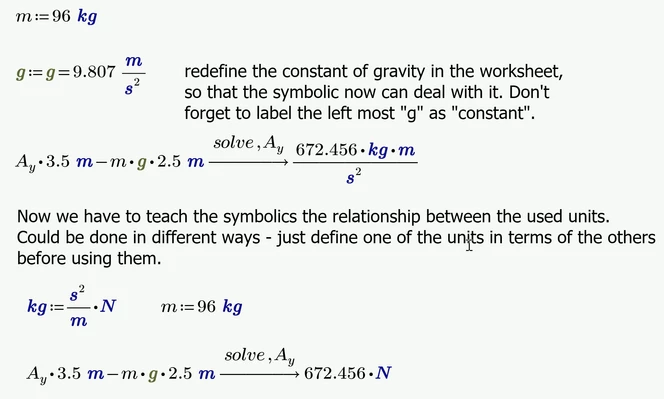

Of course you could also teach the symbolics how to handle the constant of gravity and how different units are related so that it could arrive at the desired result, but I would consider this too much effort for a a very modest achievement:
According your problem #2:
No! Sure not! Where should the unit kN stem from? The unit meter cancels, no other unit is in play and so of course the result must be a dimensionless number!
The symbolics does not know anything about the definition of "deg" or its alias "°".

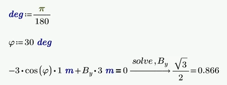

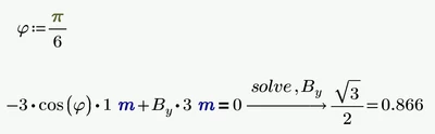

So either define your angle in radians
Or you may also (re)define the 'unit' "deg" before you use it the first time, so that the symbolics knows how to deal with it:
The symbolics returns an exact result if possible and if you rather prefer a numeric result from the symbolics you have to use the modifier "float,...".

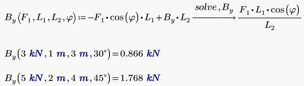

So you could set up a function for B.y which depends on the force (3kN), the two lengths involved and the angle. This should be done before any of these variables are defined.
You can now use this function (numerically evaluated) to immediately see the effect different input values may have:
