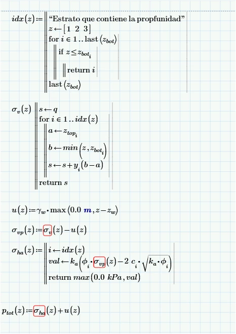

I need to evaluate anchored walls, according to FHWA Circular 10, for various strata, but I've had problems with the definition of a vector i. This new version of Circular 11 changes the definition of a vector, so could you help me with this problem?
Regards.
For loop and return for a vector i

Your function idx(z) has a parameter z, but redefines it internally to a row vector [1 2 3]. So the parameter is never used.
Then in the for loop you try to compare that z with elements of z.bot. Are the elements of z.bot row vectors of  3 elements each?
