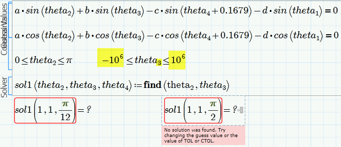

  • I played around with the first solve block and the constrained for theta.2 and wondered, why the value of theta.2 is that big when we do not constrain it (picture 1).

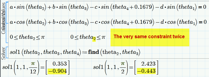

  • I wanted to add a similar constraint for theta.3 and first just copied the first constraint which i had now twice. You would expect that this does not change anything, but far wrong - the value of theta.3 changes!!! (pictures 2)

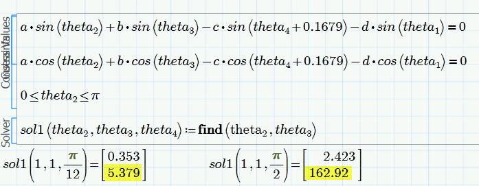

  • I then changed the the second constrain to apply for theta.3, but now the solve block failed. I allowed theta.3 to be in the range from 0 to 2*pi (there sure has to be a solution in that range) but to no avail - that alone would apply as a bug, I think. Then I changed the range for theta.3 to -10^6 to +10^6 but Prime stills does not find a solution!! (picture 3). Even larger ranges may give a result for one or both of my evaluation.
