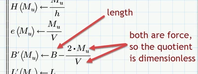

Okay, you fixed the previous error.
I can't run your file (I've only got Express--no programming), so this is only a guess, but I'd suspect that the root function is failing to find a root.
Might want to see if you can localize that issue, and/or wait for someone with full Prime to take a look.

I think Fred is right.
Your function has "incompatible units" but gets down to the call to the root function.
Put a "return" just prior to the root call to examine the root parameters.
Good luck.
October 1, 2020
Trying to add a length and a dimensionless quantity can't work.
Check your equations and units.
