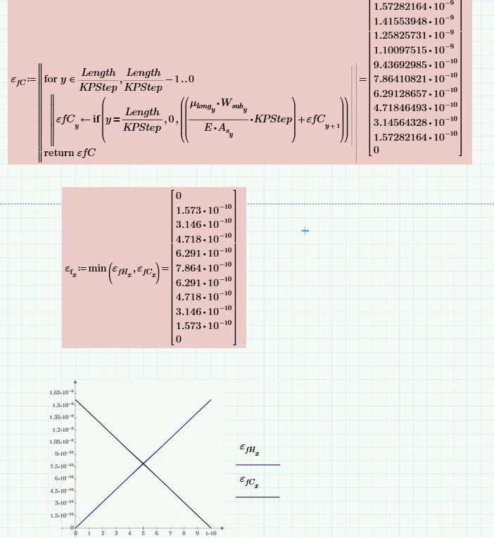

Program not working after conversion to Prime
After conversion to Prime 6.0, my simple program equation is not working but it is still calculate in MathCAD 15. Dont see any problem with the equations.
Please help
David
DJFAnswer
April 3, 2020
Try this.  Add the return in the program, and I think another programming double-bar on the left.
then retype the min statement, select min from the functions as it seems to get confused on which min you want (since it means different things, e.g. a unit)2020-04-03_13-33-01.jpg

Had to rework a bit to use Express, found some "divide by zero" faults.

Hi Fred,
You are absolutely correct, answer came out to be zero without the double bar suggested by DJF.
Regards
David

8-Gravel
April 3, 2020
Hi DFJ,
Thanks. You absolutely naid it. Once the double bar and return included in the logic the program return the value.
Kudos to you!!
