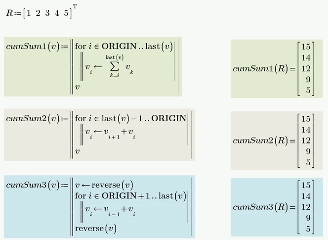

April 17, 2022
Here are a few suggestions for functions to do the job.
On contrary to Stuart recursive function, none of them will deal with a scalar as argument and the last two fail if the argument vector has just one element. Would need to throw in an "if" to deal with that situation if necessary.

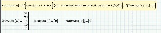

April 17, 2022
And here's one possible (recursive) functional solution ...
This function will return a vector even if its argument is a scalar.
Stuart
April 17, 2022
Here's one approach. Should work for any length vector >0  and with any value of ORIGIN.
Werner_E25-Diamond IAnswer
April 17, 2022
