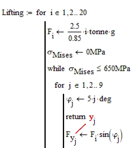

I'm trying to write a small program that calculates a new force for each increment. Each force will calculate the von mises stress at different angles
Edit:
My desired output is the force (for each increment), von mises stress and corresponding angle just before the yield criterion.  (see file)
Not sure how to finish off my program.
Regards
Sigurd

It is a good trick to use the return operator in programs

I spent the better part of yesterday working on this problem.  The solution I provided did not examine the theory, just sorted out a programming issue that had been presented.
So I missed a basic issue:
       Von Mises stress looks at the total stress picture of a particular loading for comparison with a material failure or yielding condition; it gets a lot of use in finite element analysis because it can show where the critical spots are regardless of what stress component made them critical.  If you think about that for a minute it means that the Von Mises stress at any particular point cannot depend on an orientation of the frame of reference.  Yet that is what you're asking the me to do, "What is the Von Mises stress at different angles?"
I don't believe that the problem as posed in the file is correct.  When I have a better answer I'll post it.
