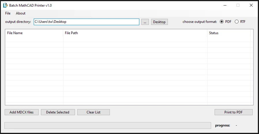

Aug 10, 2023 7:16 AM UTC
Hi
I found this topic very interesting so used my (little) programing skills to write simple GUI program for my own use, that allows batch printing of MCDX files into PDF and RTF files. Works quite fine, it processes as many files as you load into it (as long as you do not mess with it on purpose) 😀
Anyway, can share it from my side, but I am not sure what about legal thing of this.
It is single exe file, that was buit on my computer and as I understand it contains MathCAD API *.dll burnt into it (which is not mine, but PTC owns it). So is here anyone from @unknown PTC MathCAD that can say something about legal issue of sharing such exe for the comunity?
It hasn't been written for commercial purposes, just to speed up work and to learn C#, so I do not guarantee that it will work once I share it.

Aug 11, 2023 11:46 AM UTC
Couldn't edit my previous post, so adding reply.
I figured out how to not 'bake' Mathcad *.dll into the app, so sharing the app with you. Now app uses link to the installation directory and checks it every time you want to print.
PS: read the readme file first. If it will not work. Probably you installed the MathCAD not using default directory, so you must provide proper path in 'config' file.
Good luck!

Jan 22, 2024 11:38 AM UTC
Thanks for the tool, but unfortunately the tool crashes (see error message below) despite the .dll is present and the .config file is correct.
Does anybody have the same problem or - even better - knows a solution?

Our team was running into this issue, and we finally got frustrated enough to build out our own app.
We built an app that lets you drag and drop 100+ MathCAD Prime calculations and batch-publish them to PDF.  You can even choose to get individual PDFs or a single binder at the end with all files combined.  We even built in a progress bar with estimated time remaining, an error log for troubleshooting, and, best of all, background processing.  This means that instead of losing time while files are being published to PDF, our team can start the process and continue using MathCAD Prime on other calculations.
This is a tool that we would have purchased if it existed, but since it didn't, we built it for ourselves and figured we'd share it with the community.  Link below if anyone's interested.  Happy to answer any questions.
https://ssellc.gumroad.com/l/mathcadprime
