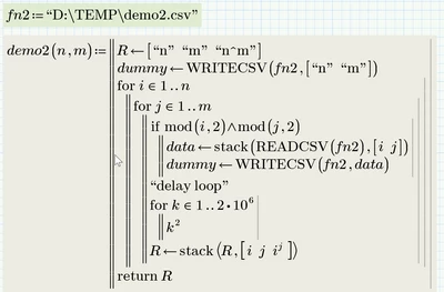

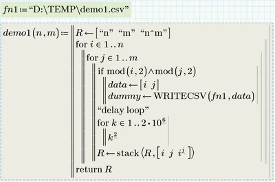

Here is a demo program which creates a csv file from time to time.
Drawback is, that each call of WRITECSV overwrites the previous files.
If this is not desired, you may read in the csv file, add the current data and write all data again in the file. Of course the file reading would once again need some time and slows down execution a little bit.
