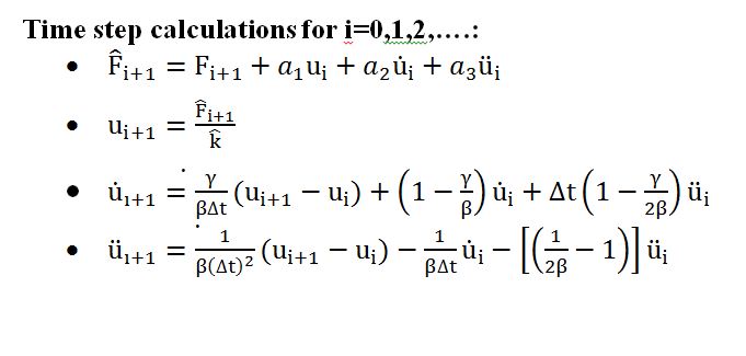

Hi everyone,
Can anyone help me to program this plz:
Knowing all of: Fi, a1,a2,a3, gama, beta,delta t and u0, u̇0 and ü0
Thank you

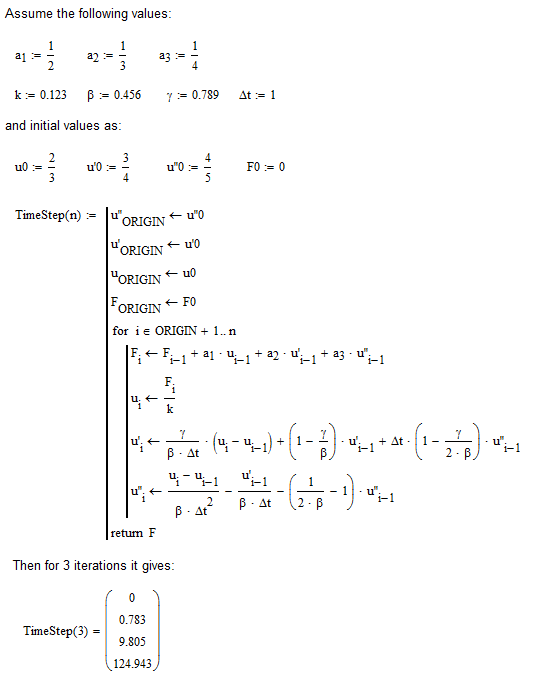

Something like this?
Note that I assumed you made errors which I 'corrected' in:
- the first bullet. Fi+1 = Fi+...
- the third and fourth bullets. ui+1 = ... instead of ul+1=

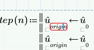

i have this issue which says that origin is not defined
im using mathcad prime 3.1
and if i do origin=0 i'll have (i) is undefined

23-Emerald V
March 21, 2016
Its ORIGIN, not origin, that is a defined item in Mathcad.
I don't see an undefined i.
If you want more results, then return all of them in a vector or matrix, like e.g. ( F u u' u'' ).
March 20, 2016
You do not specify how to calculate Fi+1 from Fi
March 21, 2016
i have all Fi which is a matrice
