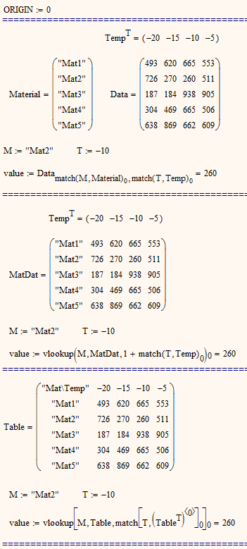

Not sure if you intend to use Mathcad 15 or Prime and i don't what exact structure you have in mind to represent your data in Mathcad (row and column header as vectors and raw data in a matrix or a full table with row and column headers included).
So here are a few ways to do what you want (no error checking implemented:

Yes, this  is possible; a search of this forum may locate a Mathcad sheet that shortens your development time.
Mathcad is quite adept at arrays.  The Mathcad function "match" will allow you to locate positions in an array.
May 18, 2017
Yes, its sure possible and its far easier to implement than you think as you don't need to program loops yourself. A clever combination of one of the various lookup function and the match function will do the job quite easily.
Furthermore you could as easy interpolate between the values so that also a temperature of. lets say, -17 could be chosen - if that makes sense in your application.

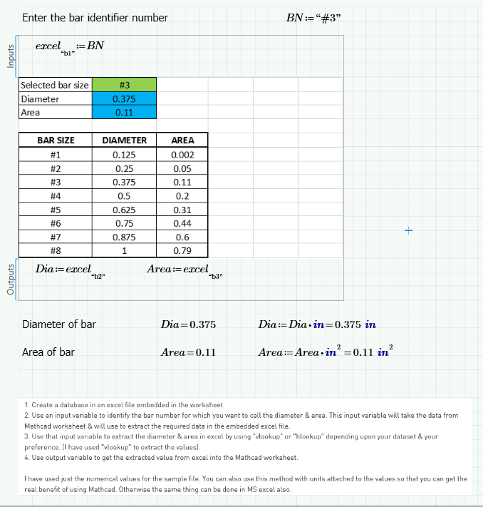

May 18, 2017
Maybe something like this?
I hope this helps.

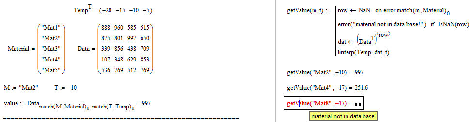

May 18, 2017
Here is a way to use interpolation. Its easiest with separate row and column headers but could be adapted for other structures as well.
Here a simple linear interpolation is used - could be easily changed for a spline interpolation.
