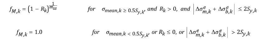

Dear all,
How can I set this programming function in mathcad 15?
Regards
Stefano

Stuart uses the symbol in the 'if' statement
which is the mathematical notation for a logic AND operator, simply because multiple conditions need to be satisfied simultaneously.
(just like there is the OR: that you can use when one of a number of conditions needs to be true)
They are found on the pallette with boolean symbols.
Now to your:
There are two types of subscripts used in Mathcad. Real and literal. Real subscripts are used to point to elements of a vector or matrix, as Stuart explained following his explanation on programming. The other type of subscripts is a literal subscript, which just puts part of the variable name in the subscript position. You type it by using a dot: '.'. So if you type a variable name in with: A.b, you get .
You cannot nest literal subscripts. Typing A.b.c gives you . Notice that the second dot gets visible as a dot.
When you type A.b,c you get . This means you're addressing the c'th element of the vector A.b. Essentially there are two variables here, separated by the comma: the vector A.b and the (index) variable c.
You can, if you really want to, embed a comma in a subscript, without it meaning the separation of two variables. By pressing [CTL-SHFT-k] you enter symbolic entry mode where you can enter symbols that show. To exit symbol entry mode press [CTL-SHFT-k] again. So to enter the DeltaSess,k variable as a single variable you should type:
D[CTL-g]S.ess[CTL-SHFT-k],[CTL-SHFT-k]k.
{The [CTL-g] is to convert from d to delta.}

Stefano Milani wrote:
Dear all,
Regards
Stefano

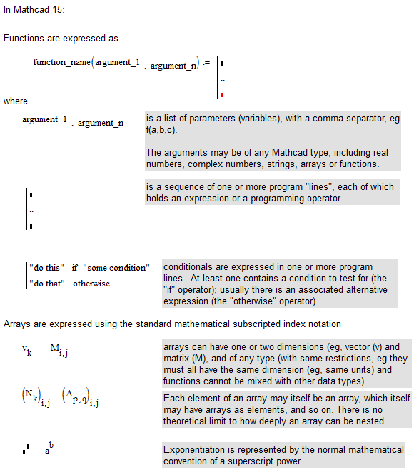

The general structure of a conditional program in Mathcad is something along the lines of ...
Here I've simply used the catchall "otherwise" (equivalent to "else" in many other programming languages) rather than type in the whole of that expression.   A word of caution here ... you have to be careful to make sure that your conditional catches all of the possible outcomes - in this case, you'd probably want to use another "if" statement for the second case and an "otherwise" to trap anything that didn't meet these two conditions.
The specifics of how you implement this equation depend upon the exact nature of your expression. Is f a function of the two arguments M and k? Or is f a matrix (tensor?)?.  If your Delta-sigma with the parameters e, m & k is meant to be a tensor, then your first problem will be deciding how to represent the data in Mathcad, as there is no inherent Mathcad support for tensors - a nested array may be the way forward.
More details on what the expressions mean would be helpful.
Stuart
smilani1-VisitorAuthor
November 8, 2016
The output value must be only a number (not matrix/tensor etc..) M and k subscript are only for  definition value (is a coefficient used in mechanical fatigue analysis and k indicate a stress state).
In this case the previous expression is correct? In your expression how can I obtain the following symbol?
and how can I insert "," in the subscript?
This  symbol (symbol.png) what does it indicate? and?
Best regards
Stefano

OK.  However, without some background on the notation, I can't offer much more guidance - notation, particularly domain-specific notation, can be difficult to interpret (eg, I'd have put good money (maybe as much as 0.01 euros) on this
being a tensor ("e" being italic makes it seem like it's a variable rather than the mathematical value 2.718281828459...
Do you have a reference to a website or pdf document that explains what you want to calculate?
Here's a brief summary of some of the kind of notation you might find useful in Mathcad 15 (Mathcad Prime has some subtle differences).
Stuart
