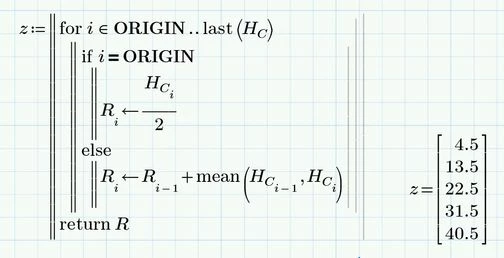

i am trying to program ;this routine (that i picked up from another topic here, originally written in mathcad 15) to calculate the depth to the midpoint of each layer.  the results for z should be 4.5, 13.5, 22.5, 31.5, 40.5.
any assistance would be appreciated.  the file is in mathcad 4.0

Would this help?

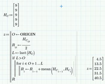

And here is what you probably were trying to do
