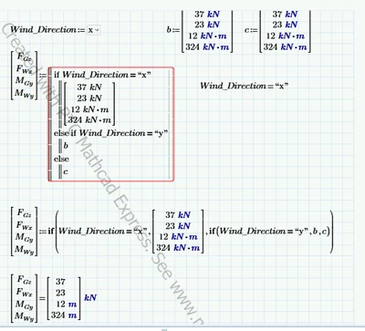

I'm trying to build a program so that when I choose a variable to present a set of calculations but when I choose another variable to see in the mathcad spreadsheet another set of calculations. Do you know if this can be done?
I was thinking the a,b & c to be different mathcad sheets. Please see attached

Something like this, Eleni?
The programmed version should work in Mathcad Prime 7, but I've only got Mathcad Express 7 so I can't check it.
The second version (using if functions) works in Express.
I've explicitly defined the values for a simply as an option, or you could define the values externally in variables, as I've done, or even in a matrix and select the appropriate column/row.

Unfortunately, no
I didn't make it clear, sorry. What I intend to achieve is to give different input values as the direction changes.
Eg
If wind in x direction then I need to input the moment in y direction eg Mwy but if wind in y direction then I need to input the moment in x direction eg Mxy. And then based on these inputs present only the calculations that correspond to the specific wind case. Like a mini program.
Is it any chance can this be done with mathcad?
If not, is it any chance of changing the subscript between x and y to the moment following choosing y or x wind accordingly?

I don't think you can programmatically choose a sheet (whether or not dependent on the value of a variable) to work with.
If your calculations are independent on the wind direction then whatever Stuart suggested should work for you.
If not, try to approach it as follows:
You have four parameters Fgz, Fwx, Mgy and Mwy and the wind direction Dir. Now define functions for any calculations that depend on those parameters.
E.g.
Fdx(Fwx,Dir) := If (Dir="west", Vq*Fwx, <Whatever if it's not west>)
Mdx(Fgz,Fwx,Mgy,Mwy,Dir) := If(Dir="west", Vg*(Fsw*L/2 +Fgz*x)+Vq*(Mgy+MWy+Fwx*h), <Whatever if it's not west>)
etc.

Not sure I understand exactly what you're after but this was my take.
Write 3 functions (programs) - one for each way the wind blows.
Have a program similar to yours with IF statements and only call the function needed based on the input.
It might not be the most condensed way, but should work.

Prime 7
Definition of function
Do the function.
